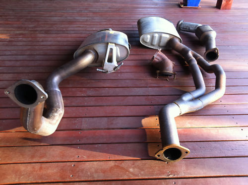

  2. I'm going to swap the whole centre section with single 3" (in other words no merge, or twin pipes merge, or muffler). This means it will be single 3" all the way. Booked in at Dandy exhaust- $250 for a complete replacement section fitted with flanges. I keep my stock section in case I need it later.
  3. I've seen replacements which are single 3" all the way, so basically you throw away the whole factory centre section...

  5. Hi guys. The FG Turbo exhaust is 3" but splits into two 2.25" pipes for a small section in the middle ahead of the centre muffler... Using mathematics: a) The area of a signgle 3" pipe = (1.500*1.500*3.142)*1 = 7.07 Inches Squared b) The area of twin 2.25" pipes = (1.125*1.125*3.142)*2 = 7.95 Inches Squared <--- 12.5% more area for air flow The question is, why has Ford decided to put this section of twin pipes in the middle section, and does this need to be considered when changing the stock centre muffler section? In other words by removing the centre muffler section, and replacing it with single 3" does this have a potential adverse effect? By the way a 3.5" single pipe has 9.62 Inches Squared of flow area. I would have thought that Ford has put the twin pipe section in simply to modify exhaust note...? Cheers, Jake.
