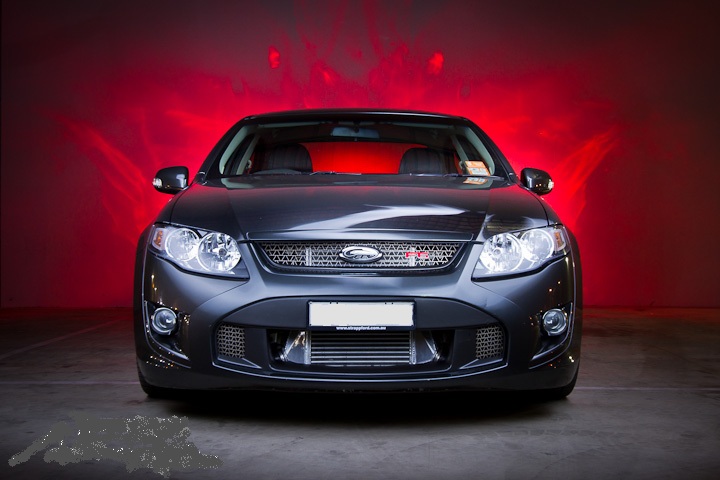

  9. Jake F6
    Here She Is
    Awesome! Would you consider running rear mufflers only like they do in the 5.0 mustangs? IMO these sound sensational.
  10. Thanks for all the nice comments guys. I forgot to mention, I also have the rapid turbo intake pipe (doesn't seem to make much difference to induction noise). I'm happy with the power, so that's it for the mods other than the 'tidy up' stuff I listed above. I will be fitting a reverse camera next week though. Potentially a bit of extra induction spool noise ld be nice. I guess a growler could do the trick in place of the XR8 intake.. Cheers, Jake.
  11. Hi Adam, I wasn't sure whether I was allowed to post the pic with your trademark on it... So I removed it when I erased the number plates. Jake.

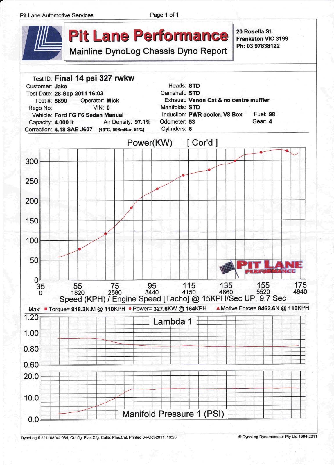

  13. I have been meaning to get around to writing this up for a while... I dropped in my FG F6 to pitlane a few weeks ago for some work, and came out with 327rwkw, below is a list of mods: 1. PWR Stepped cooler 2. Venom Cat pipe 3. XR8 Intake & lower box 4. Herrod pipe kit 5. XCAL 2 6. Blocked BOV 7. K&N Filter 8. Custom centre exhaust section 9. Tune and work from Pitlane Servicing done at the same time: 1. Throttle body clean 2. Change manual gearbox oil (Transmax Z) 3. Diff oil change (85w-140 Mineral oil) 4. Fuel filter change 5. Turbo oil screen change Big thanks to Mick & Bel for the great work & service again. I have finally got Ford to replace the diff and tailshaft too under warranty (after 4 visits) which was so clunky and noisy and leaky that it was unbearable. The car is now brilliant. Last few things to be tidied up: 1. Fix AM radio reception 2. Fix driver door wind noise 3. Change diff oil again (85w-140), since Ford supplied new diff 4. Get a few small paint scratches sorted. 5. New valve springs (Next time I'm at Pitlane) 6. Mal Wood Opt 3+ (when current clutch goes - holding well so far) 7. Replace clutch fluid 8. Fix slight exhaust knocking around (extra hanger?) Jake.
