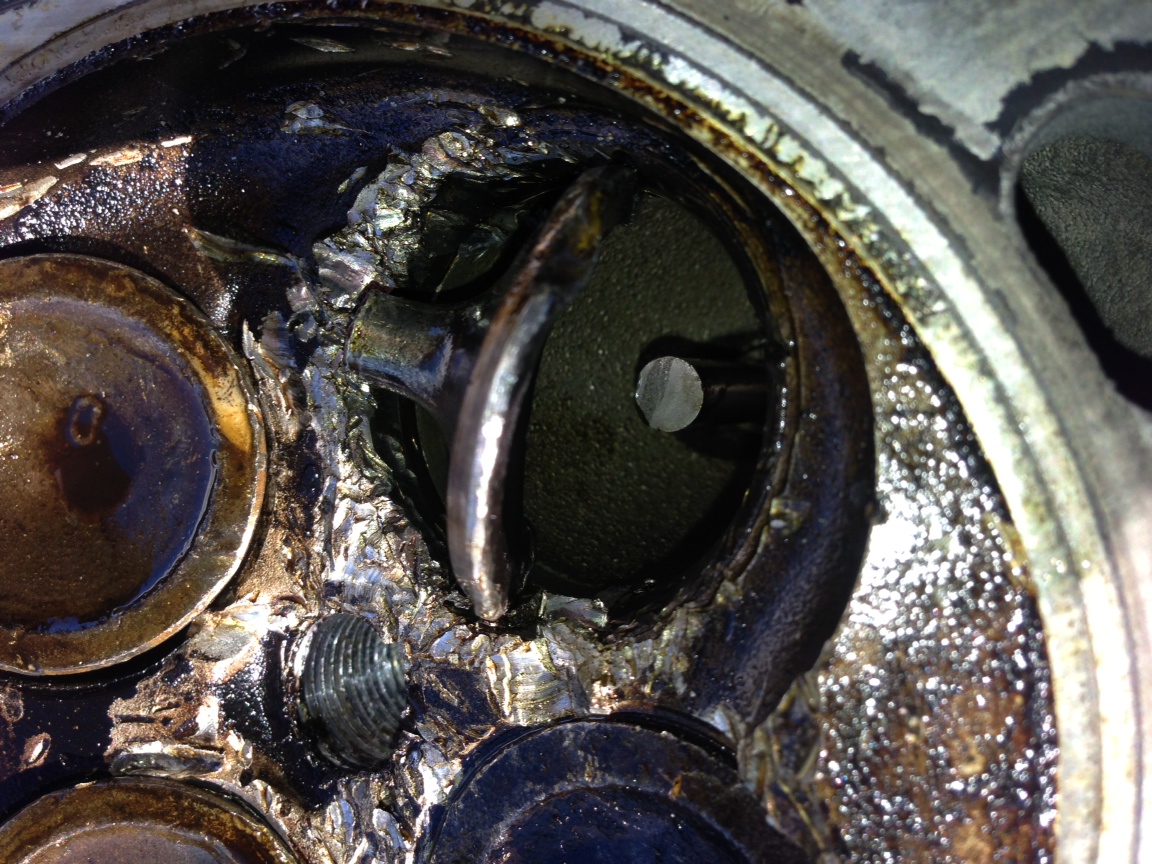

  5. Valves are not designed to make contact with the pistons and this has obviously happened. Not sure if I should remove any valves from the cylinder head to see if there is a slight bend on them or if I should get prehaps a third party to investigate?

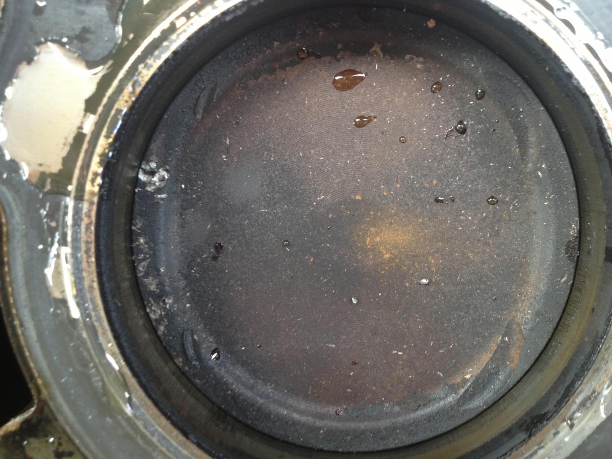

  6. Had the head off today and found marks on all the pistons! The marks are quite obviously from when the timing jumped 2 years ago as the car has had nothing done except the log book services. So I called ford and told them what had been discovered and they said that the valves couldn't have been bent as they did a compression check. After a heated discussion I ended up down there, which didn't achieve much,. but at least they said they would send the details on to ford and see what they say. I have attached a pic (note it is not the relief cuts on the pistons but the small indents opposite them)
  7. It didn't drop the collets just let the head go
  8. Don't think I will waste my time, anyone have a complete motor laying around or should I look at going the rebuild.
  9. Hi Guys Has anyone ever heard of FG's droping valves? Unfortunately today mine did, It is stock as a rock and 9 months out of warranty so I think this is going to hurt. The car has always been driven hard but at the time it went wrong I was driving on the cruise control so I certainly didn't rev it too hard. The only thing I can think of is that about 2 years ago it broke a chain guide and was fixed under warranty, is it possible that it tweaked a valve that long ago and only just let go today?

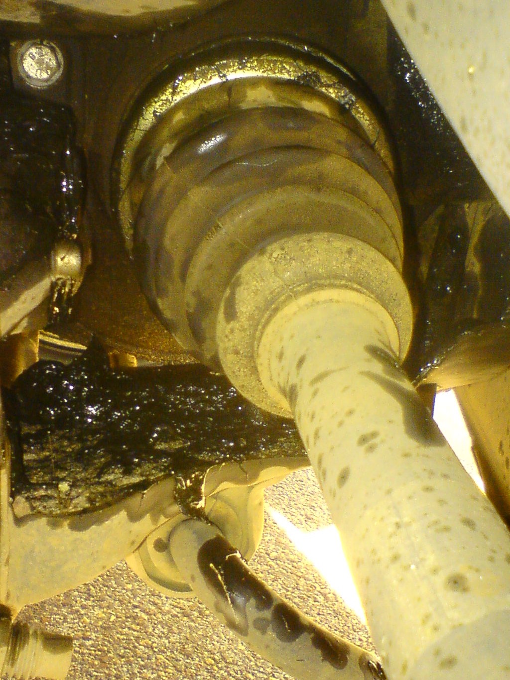

  21. With only 6k on the clock this had to hurt

  24. Things didn't go exactly to plan but still had a good time setting a new pb of 13.2 in my manual BA and 13.06 in my auto FG ute so well impressed at the ute unfortunately the BA rode home on the tilt tray as Sammies launches managed to destroy a CV
