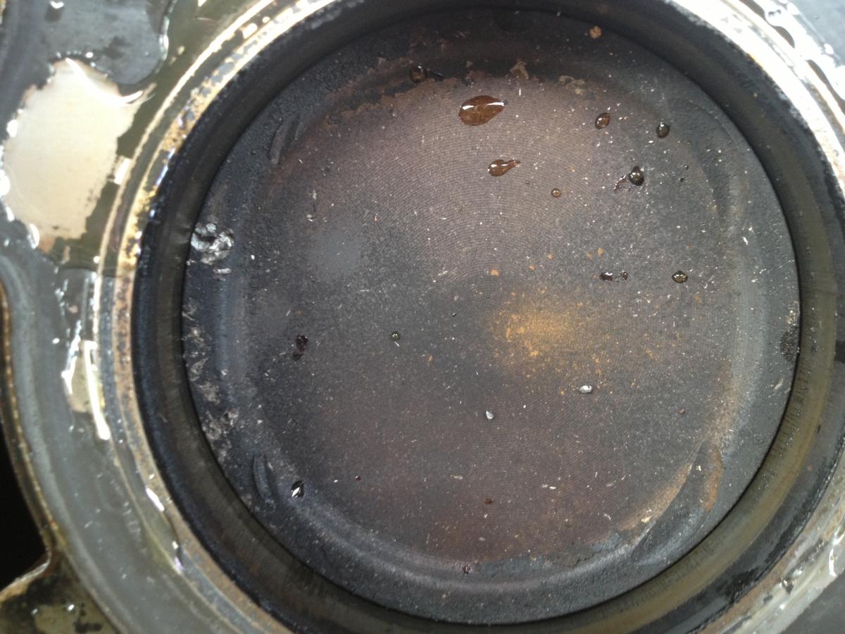

  2. My BA is tuned my FG is stock.

  5. Valves are not designed to make contact with the pistons and this has obviously happened. Not sure if I should remove any valves from the cylinder head to see if there is a slight bend on them or if I should get prehaps a third party to investigate?
