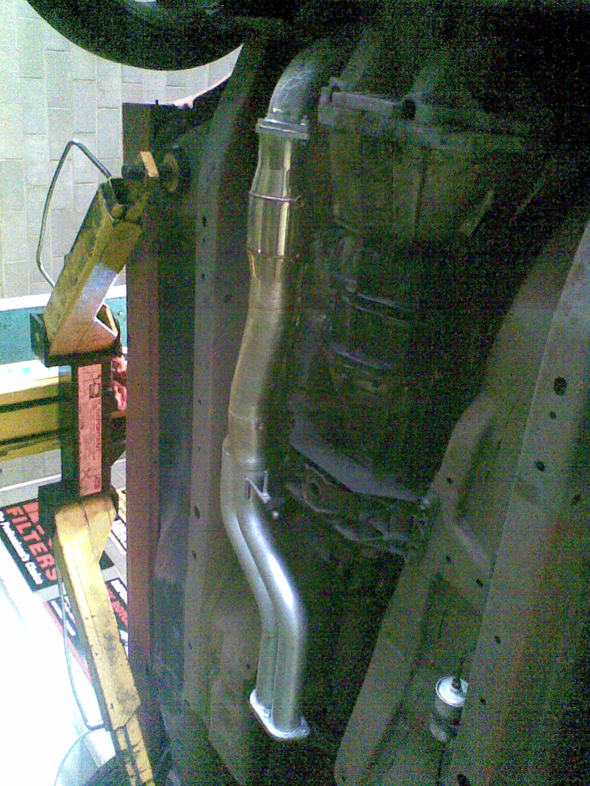

  10. better late than never, mechanic had dramas fitting new clutch so apologies for the late photos. dodgey mobile photos please excuse quality. 3.5" metal cat flanged to stock dump (S/S) x-force 3.5" - twin 2 1/4" splitter (MS) dump -> cat -> splitter -> stock rear flange twin 2 1/4" hotdogs looking towards cat (Ms) Verdict, Love it! all flanged connections for easy removal Not good if you have a headache though Kudos to RAP1D Systems for the rear milo tin set up and Kirrawee Mufflers for the excellent craftsmanship and price ( 02 9542 4111)

  13. Imagine if they got there hands on a stock T They proabaly wouldn't know what to do with themselves!!!

  15. Cheers didnt mean to rush ya! missus was going for a hot rock massage... All I will say is the Jungle Juice will put lead in your pencil haha! I'm 22 and never had it before! Organised cruise up through Peats Ridge rd would be good, turn off at the pub and go through cessnock instead of the dirt trail you wre taking photos of (I got that far and turned around) Was great seeing a fellow member out and about, will definatley meet up ona crusie mate. keep safe Ryan

  23. Got done today - 3.5" metal cat to stock exhaust with xforce splitter (3.5" to twin 2 1/4") - replace centre muffler with two hot dog style resonators $70 per side
