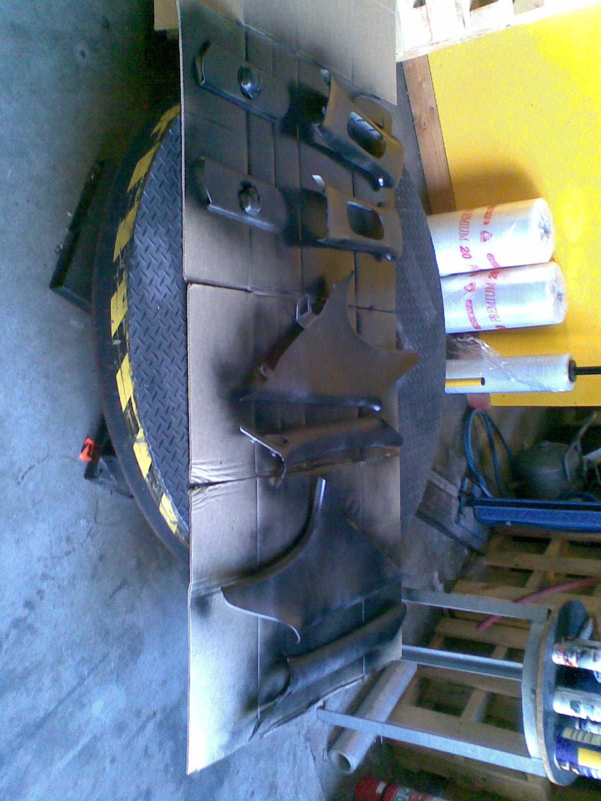

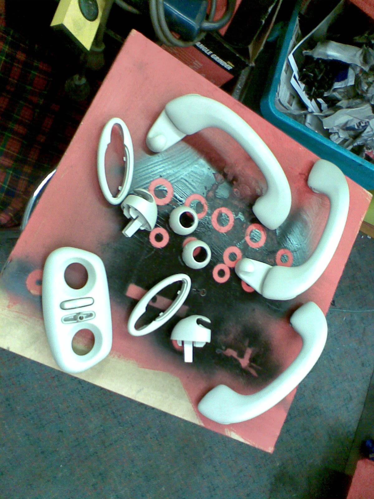

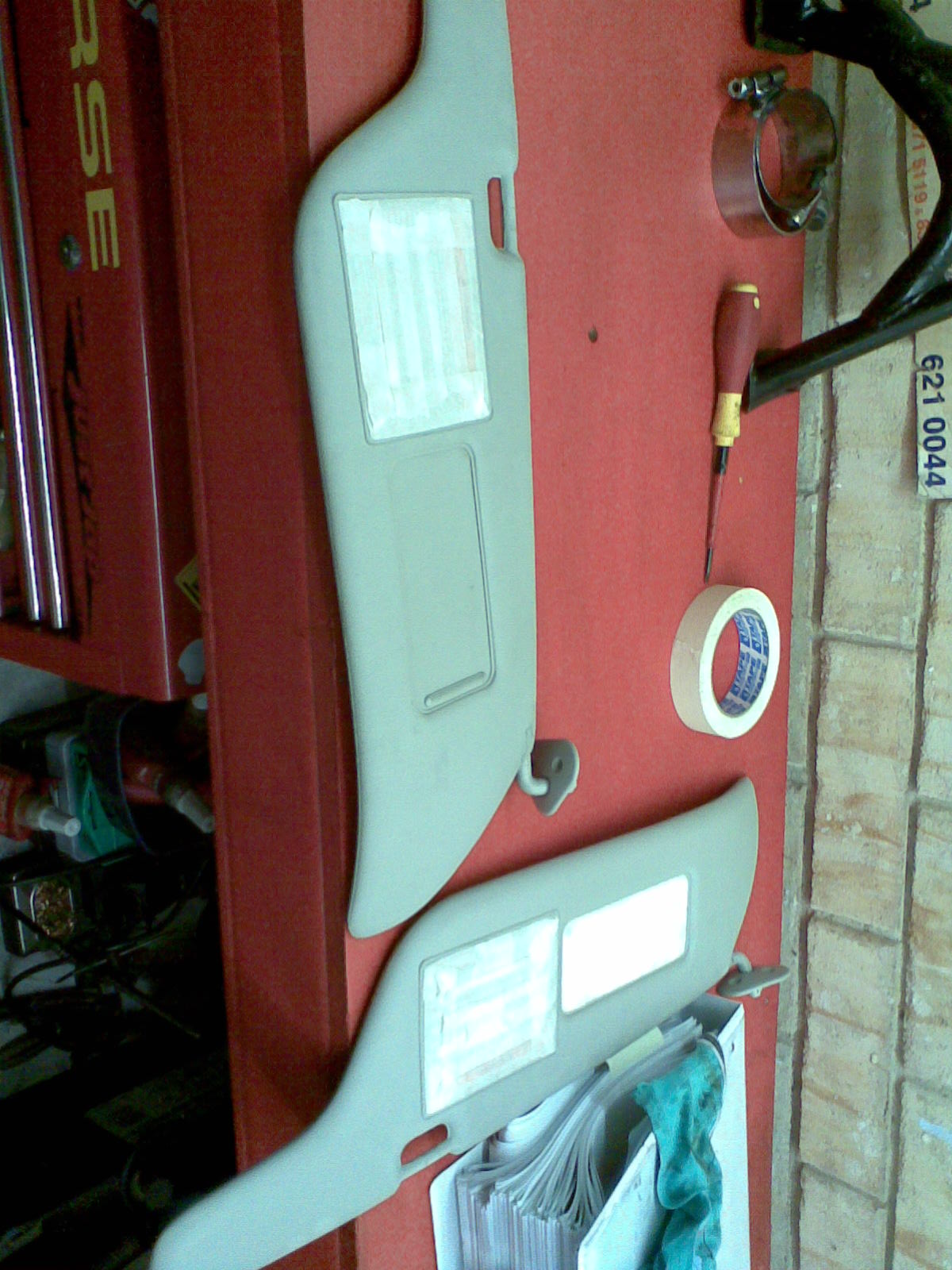

  16. So I got bored during my last day at my current job and decided to show the start of my Interior Mods. Trade price from mates at Domenelli Ford Kirrawee netted me all new A, B & C pillar garnish's including Tweeter Grills. Out Came the Factory Air vents on Drivers and Passengers sides, A, B pillars, out came the Lap Air vents. Also to come out where the Sunshades, Grab Handles, Map Lights, Courtsey Lights & Suit Hooks. A, B, C trims new (dismantled) Sunshades and misc parts Dis-mantled everything I could (vents broken right down) Grills out. Map Lights dis-Mantled. Mirrors masked up. Safety Instructin masked. Broke out the Plastic Primer, Emery paper and Pressure Packs. Wet n Dry sanded everything back, plastic primed and then manly lights coats of black or metallic to match the ICC. Tweeter Grill Done in the ICC metallic to contrast, Pillars done in Black. Clear Coated everything after good coverage with base coats. Painted A. B & C Pillar Trims Dismantled Installed new painted A pillars and Tweeter grills. Re-assembled Vents, re-attached map lights, courtesy lights (replae globes), grab handles, coat hooks. B pillars installed (seat belt needs to be removed to do this) Yet to install C pillars (parcel shelf needs to come out) and re-trim roof in Black Suade (will be sent to a professional to be done) More to come yet! More picture up soon! What do people think so far???? Ryan
