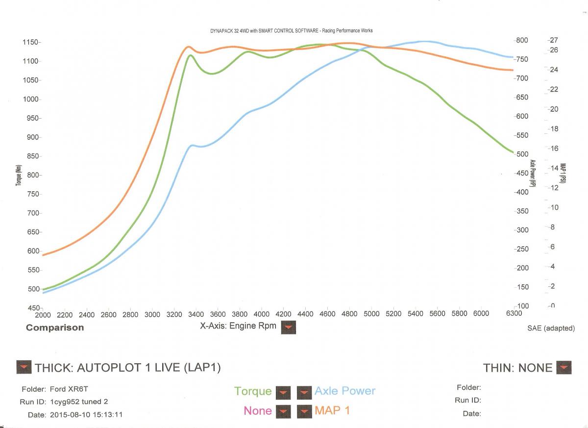

  3. Yeah, had 2 separate issues causing over boost. The first one was boost spike on gear changes in 3rd & 4th. We believe from the blow off valve being small. Boost was spiking 5+ psi. The second was a restriction from the intercooler at high rpm. We were still using a PW stepped cooler at this stage, had a 6 psi difference from hot to cold side of the intercooler. The result was a spike to 30+ psi when there should have been 21psi.

  6. Yeah, 4th gear on low boost (16psi) stopped the dyno. Ended up running in 5th with fast ramp rate. Didn't hit the speed limit, turbo was maxxing early so stopping run at 6400rpm, I think road speed was about 275kmh.
