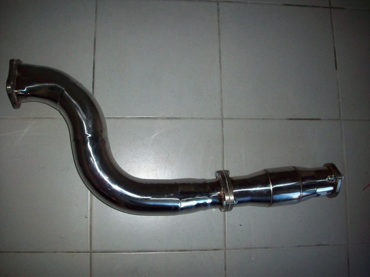

  10. Do you have any pics of your rear setup? how is the trailing arms setup? cheers Josh

  19. dump
