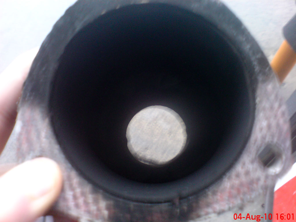

Yeah got into it today a couple of times and had one massive backfire. Might be over boosting but then again, plugs are just copper v-groove and are a bit old as well as the coil packs which have seen over 6 months so might be time for some fresh ones. I'm keeping off it anyway until I do get it looked at. I heard XForce changed their CAT design at some point to remedy this issue. Apparently the substrate was in it's own case then that case was welded to the CAT body? My system is over 2 years old so probably an older one.
Hey All, This is the latest 1 cpm XForce CAT. Ultimate flow, increased spool and nicer note. But seriously, for the last couple of months, my car has been running like a Holden. Very down on power, low boost and exhaust note had become very quite. I had a feeling there was a problem in the exhaust (genius). Took it to Glenroy exhaust yesterday and found the CAT had dislodged and found it's way into the rear muffler.Cleaned it up, bolted back together and now it's all again Cheers, Steph.
