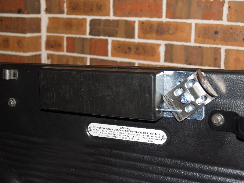

  18. Hi Tab, Sorry about the delay but I had an APEC free weekend in Mudgee checking out the vino. You need to have a little clearance so that the actuators can lock. The instructions call for 2mm but I have mine just sliding as I was worried about the same thing. They still work fine and the lid doesn't rattle around either hot or cold but I have the BF style with the hump - a mate of mine with the flat lid says his tends to curl up and down depending on the day so that might be why they call for 2mm???. I have had no issues with water through either rain or the automatic carwash and the back is still dust free at this stage (dust can get in through the drain holes in the front of the liner I suppose but I havent had a problem so far). So all good at this end so far As for Rus - yep you get 2 actuators. Cheers Tom

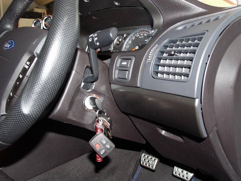

  23. Hi Guys, I installed the kit on Monday and it took around 4 hours - but I am fussy. All I can say is I dont honestly know how anyone would put up with keys with a product like this on the market. The instructions provided with the kit are clear enough and the finished product looks factory. You only need to remove both kick panels and the glovebox for access inside the cab, but I did elect to remove the instrument cluster and the tissue box holder so I could run the switch wires across to the passenger side footwell along the factory harness. This only involved 5 screws for the cluster and 4 screws for the tissue box holder. You dont need to do this - but as I said I was fussy and did not want any rattles. The extra room allows you to tie off the loom properly IMHO. Greg from Lidlok even called on Monday afternoon to follow up on how I went - exceptional service! Everything is plug and play excluding the 2 switch wires that run to the passenger footwell. These solder onto existing wires and access is good so it should not present any real issues if you have an iron. The harness is assembled from Lidlok and the lengths and connectors are correct and fit properly. I have set it up on the second unlock command so that the lid stays locked unless I hit the button a second time which will unlock it with the passenger door - or you can have it unlock all doors together. It is covered in your owners manual to set it up either way. I have attached a photo of the finished actuator installation only as the rest is covered well enough in the instructions and it is the only part that can be seen with the car complete. Like I said, the harness is pre-assembled. Cheers Tom
