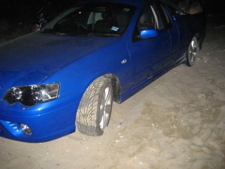

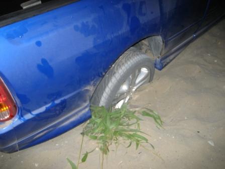

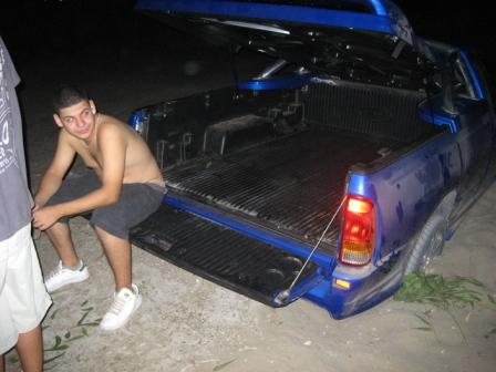

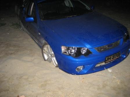

    the club I went to was next to the beach. I parked my car and couple hours later I went to leave the car park but a guy was parked behind me so I had to go around. little did I know it was worse than the sahara deserts sands!!!!. I was in for a shock and a half
  24. if you want specific blow off valve sounds just search for the name of the blow off valve and you will find video clips of the BOVs
  25. last night I was backing out of a club car park when I got bogged in the sand pretty badly. I was shocked to have found no tow points for the car where we could pull the car out of trouble from. is it just me or have ford neglected to put such things into the design of the car??? it took 8 people to push and 2 hours of shoveling to get my car out of trouble. no major damage but some scratches on the wheel from the rocks embedded in the sand.... when I couldnt find it, came to mind that maybe ford tried to eliminate the conventional towing ways of pulling and tried to make everyone call a towing specialist. because what I had also noticed is that the power steering pump tends to stiffen up even if the ignition is on and unless the car is turned on the hydraulics dont ease steering. what if your car engine is blown and u need to tow it home tied up to your friends land rover?? I dont think the streeting wheel locks up up its damn hard to steer it.
