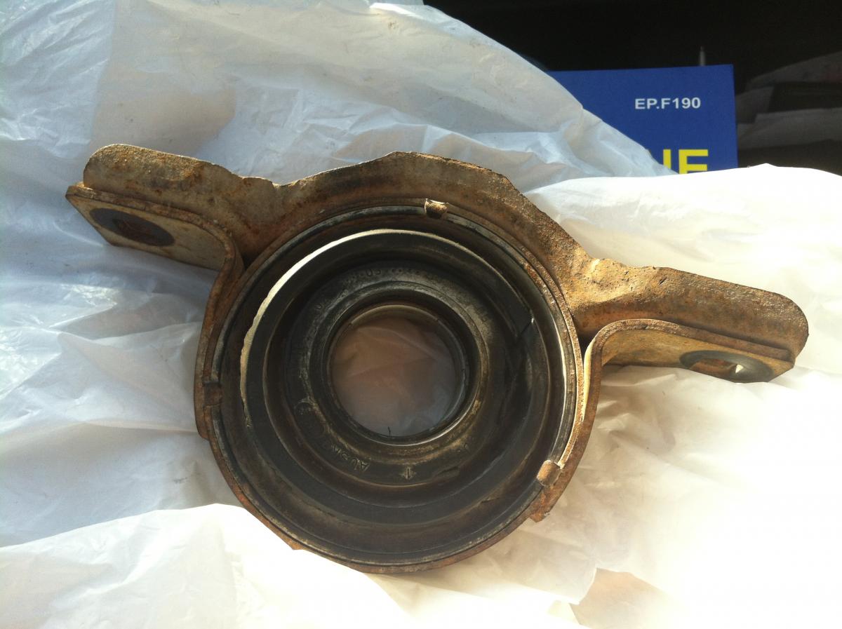

  1. Hey guys my centre diff sh*t itself. unfortunately my car isnt in oz so I cant take it to a shop to get it repaired. I need a replacement so I can get my mechanic here to do it. that's the part there its ripped apart. can anyone please help me find someone who can ship this part internationally? thanks alot.
