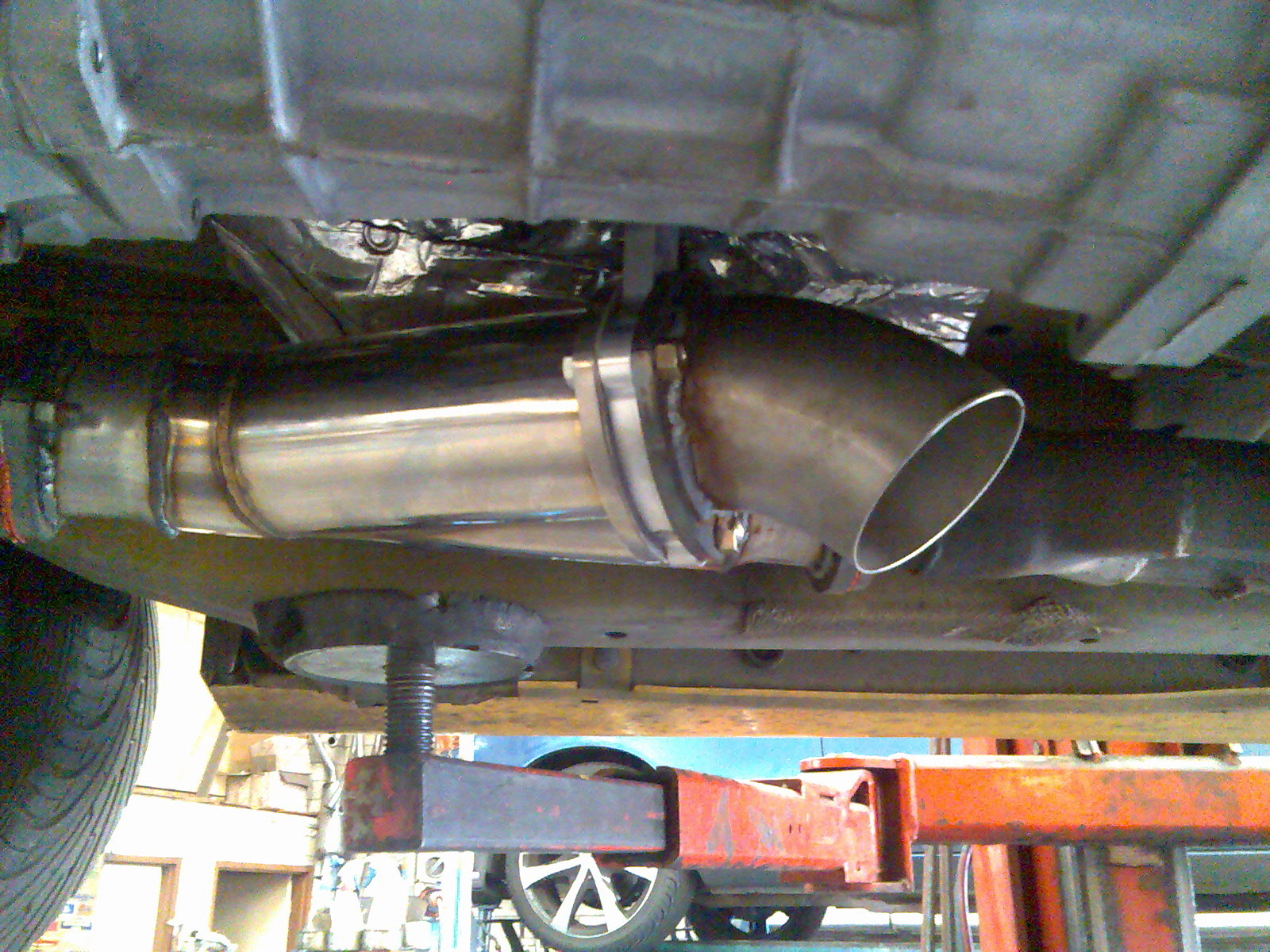

FastR1Red Member 360 Member For: 19y 5m 20d Gender: Male Location: Mt Waverley Posted 13/12/07 02:22 AM Share Posted 13/12/07 02:22 AM Finally got around to getting all the bits and fitting the new system.It's a 3 1/2" stainless Y piece that directs exhaust through the standard system, centre muffler gone etc, however the other side of the Y junction I've installed a 3 1/2" butterfly valve, similar to a throttle body, that at the flick of a switch opens and directs the airflow straight out the dump.Sounds awesome, way way too loud for the street, but great for track days and a blast up the mountains on a cold winters evening when it's nice and quiet.Getting a retune this weekend so it should be ready for the next track day. Big Trev---I'll switch it off when I come up the front straight at Winton so you don't black flag me,,LOLHere's some pics. Link to comment Share on other sites More sharing options...

FastR1Red Member 360 Member For: 19y 5m 20d Gender: Male Location: Mt Waverley Posted 13/12/07 04:22 AM Author Share Posted 13/12/07 04:22 AM (edited) Argh,,,I forgot to put that in.Stainless Y pipe complete $803 1/2" butterfly valve complete with stepper motor. $280 delivered.All flanges/pipes/bends etc plus labour to fit. $120Me to wire up the electronics FREE.I tried to get the valve from QTP in the states but they supply to Rocket Ind in Sydney and wouldn't sell direct so for a few extra $$ it was ok. All up under $500Yep, getting retuned on next week, but cos I've already done the wastegate porting etc it will only need a faily minor change to drop the duty cycle back a little in case of overboost. It hits 17psi pretty quick when opened.I'll leave it on the new tune cos with the butterfly closed the boost will be lower, maybe down to 12-13psi or so which is quite ok. Back under the 300kw mark, but open butterfly will be 14-15psi and back over 300 anyway. We'll find out next week. Edited 13/12/07 04:26 AM by FastR1Red Link to comment Share on other sites More sharing options...
