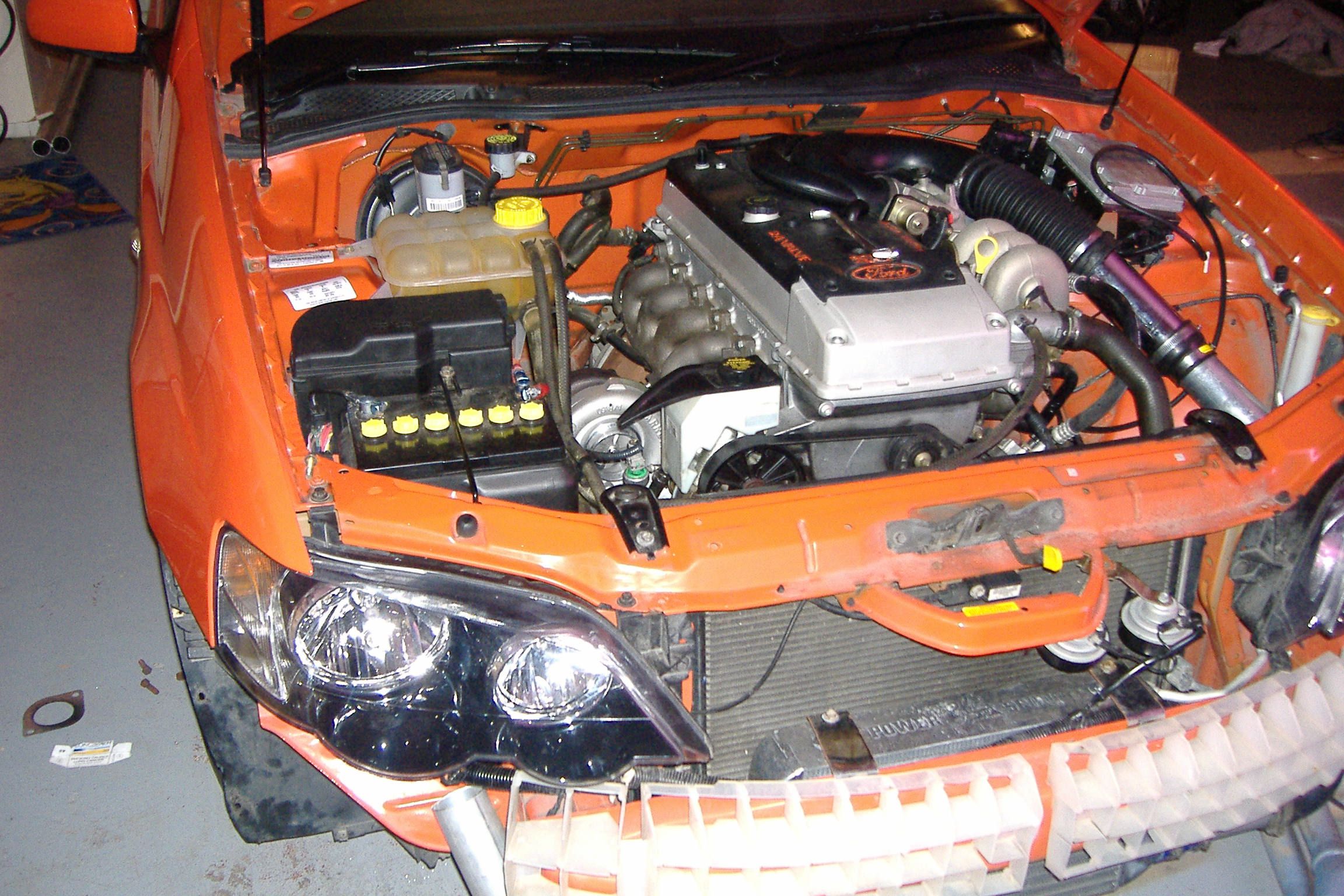

51KBA 2005 BA MK11 turbo Member 140 Member For: 19y 2m Gender: Male Location: sunshine coast Posted 23/05/06 09:36 AM Share Posted 23/05/06 09:36 AM gday guys im in the middle of turboing my n/a xr6 ute ive got most the gear im just chasing a couple more parts and a bit more info first of all can anybody tell me if the unichip control unit can control my n/a standard computer or is it only the capa flash unit that can do that?also where do the water lines for the turbo run to on the engine?any help is appreciated thank you Link to comment Share on other sites More sharing options...

51KBA 2005 BA MK11 turbo Member 140 Member For: 19y 2m Gender: Male Location: sunshine coast Posted 23/05/06 10:39 AM Author Share Posted 23/05/06 10:39 AM ebay mate just waited and found a cheap combo manifold and turbo and I picked them up cheap and they are virtually brand new that's where ive got most of the stuff for my ute Link to comment Share on other sites More sharing options...
Adam Here since the start... Lifetime Members 10,282 Member For: 21y 10m 8d Gender: Male Location: Victoria Posted 23/05/06 10:43 AM Share Posted 23/05/06 10:43 AM Is it going to work? Buying everything off Ebay sounds like a risky way of doing it. Link to comment Share on other sites More sharing options...
XtRmn8 570Nm @1800rpm Donating Members 2,441 Member For: 21y 5m 12d Gender: Male Location: Perth, WA Posted 23/05/06 10:45 AM Share Posted 23/05/06 10:45 AM Looks good so far! Is that a XR6T manifold and turbo?? If I was you I would go the Edit. Link to comment Share on other sites More sharing options...
51KBA 2005 BA MK11 turbo Member 140 Member For: 19y 2m Gender: Male Location: sunshine coast Posted 23/05/06 10:53 AM Author Share Posted 23/05/06 10:53 AM yep I guess it is a risky way of doing it but I came up trumps on this 1 it is all genuine ford stuff and ive had it checked out and its perfect I would like to go the edit but I already have a unichip here and if itll work I will use it for the moment if not ill just save more money and get the edit cheers guys Link to comment Share on other sites More sharing options...
